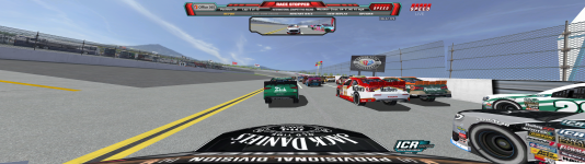

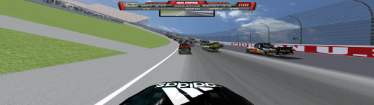

For my first few weeks on Linux and re-installing NR2003 in Lutris I was reaching pretty good fps on my 5120x1440 monitor (same one I played NR2003 o my win11 machine with). The good 100+ on all track with my ICR mod except for the performance killer tracks like modded Daytona and Talladega where at this screen-size a usual 30-40 fps on the frontstretch is expected. In even worse cases with the sun solar effect on a temporary 17-22fps drop if you don't have NR2003 tuned right for this monitor size.
I could just lower the game's resolution and upscale it back to 5120x1440 or just simply have the game in a 1920x1080 window and call it a day but no, I'm greedy and was determined to see if I could achieve even bigger gains with no compromise and well ... tonight I found how to truly unlock NR2003 to levels the base windows version with 4gb patch and the dx8 dll's can't even compare:

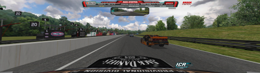

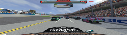

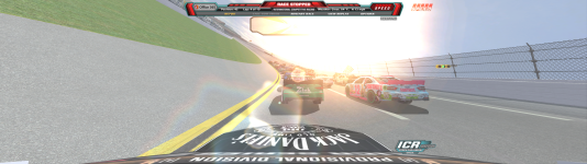

Before I show results these are the WORST fps' shown below. On any other track thats not beefed up like a Daytona or Talladega with my ICR mod and all graphics on I peg the game between100-144fps easily (I purposefully peg it to 144 because extra frames above my monitor refresh rate is pointless)
~70 FPS coming to the frontstrech and the solar effects in play with a full field
~90-100 fps on the frontstrech
100+ fps anywhere else in the middle of the pack

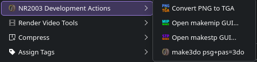

I've been testing more thoroughly all NR tools on linux, pretty much 99% of them work just fine thanks to wine. I found I can make some of them, for example the tools that run in the Konsole even better for Linux though. I can bypass having to use WinMip2's windows GUI (except for any .car file editing) which is finicky and make my own GUI using the makemip.exe with a Linux addon YAD (Yet Another Dialog) to build my own front-end apps to run the nr tools. Best part I can do stuff winmip2 won't let me such as batch file run as many TGA's/BMP's at once.
I got a little carried away haha this is like the v3 version where I just kept adding more features and included descriptions for each toggle:
Here is what it looked like when I just started, it only allowed 1 image at a time too:
Its nothing as revolutionary as @TShirt 's papy blender addon but makes any NR tools that uses a terminal a lot more flexible on Linux. The one thing (even on windows) I was severely lacking was more flexibility in making mips quicker. Winmip2 is so cumbersome having to save 1 mip at a time lol. I plan to make a STP and possibly a layout editor app tool too.
Right now its just personal tools that I can activate from my right click menu but if I can figure it out I can make these portable appimage apps where they can be run on anyone's Linux pc regardless of distro
