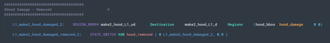

I'm now trying to have detachable parts for the SS mod. This is my code, but even after hard hits, none of the parts detached of the cars. Is there something wrong with my code?
chevy_L1_HoodScene: STATE_SWITCH VAR hood_removed (0 chevy_L1_HoodDamage, 0.9)

For hood for example my code is like this:
I have the damaged version, then nested to the removed so it can be removed. Usually the hood is removed from the pit stop if enough damage is taken.

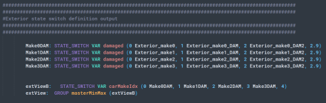

Make sure your exterior is using STATE_SWITCH VAR damaged states as well:
0 = the non-damaged exterior parts of the mod
1 = the damaged exterior parts of the mod
2 = the damaged exterior parts of the mod that also has removable pieces
