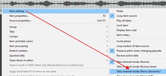

how exactly for the reminder do I change my 2 files to a mono format
Which audio program are you using? The settings option locations will differ depending what you are using. For example in Reaper here is a track and when I right click on it where I go to convert it to mono:
