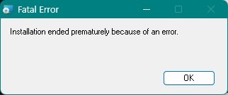

Then I get this:

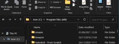

Before I Ended the installation this time I renamed the Autodesk folder to "Autodesk - From Scratch" so I still have some files.

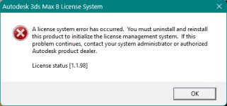

Clicking on the 3DS Max.exe it tries to start, then register product. I also quickly removed the metalray.dlz
I then enter my code:
Says it registered:
I then doesn't go though and goes back to Activate the product, probably because files are missing because it doesn't complete install.

I then named xxAutodesk, to "Autodesk - From XP" and backed up Autodesk - From Scratch (Now called Autodesk - From Scratch Backup).
Somehow Raysat is installed, and is in services.msc in Start+Run (Windows+R) and disabled it:
I created a new folder called Autodesk, placed the from scratch files in there, THEN copied the From XP files (The files missing), and said NO if there is any repeats (Skip). It then should have all the files.
